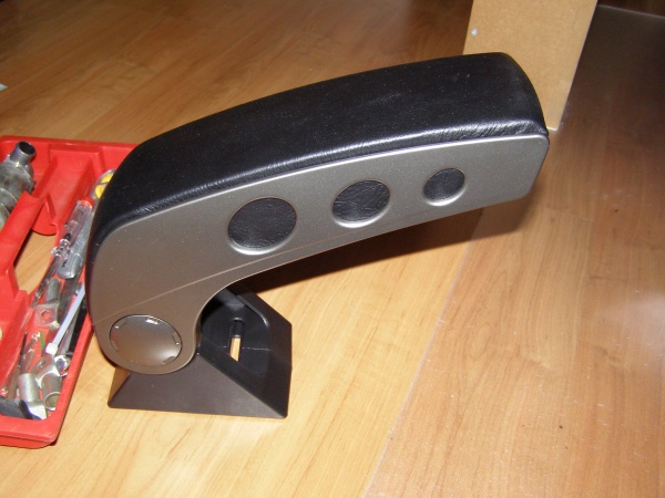

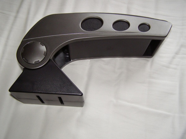

I ordered this too blingy armrest:

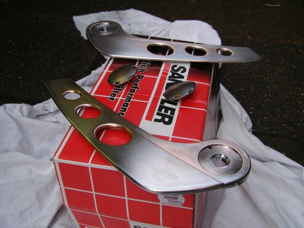

Sanding
Took the bling off :D

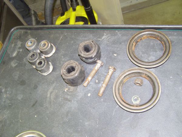

Have some bonking noises in the front I'm trying to kill.
So we're replacing everything that hasnt been replaced yet :P

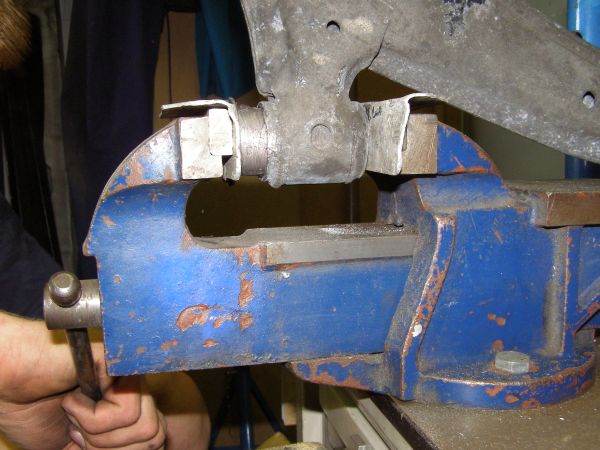

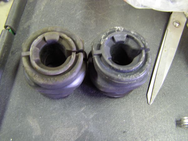

Front wishbone bushings
ARB bushes

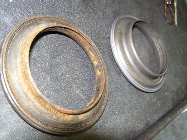

Strut bearings
Old stuff that came off

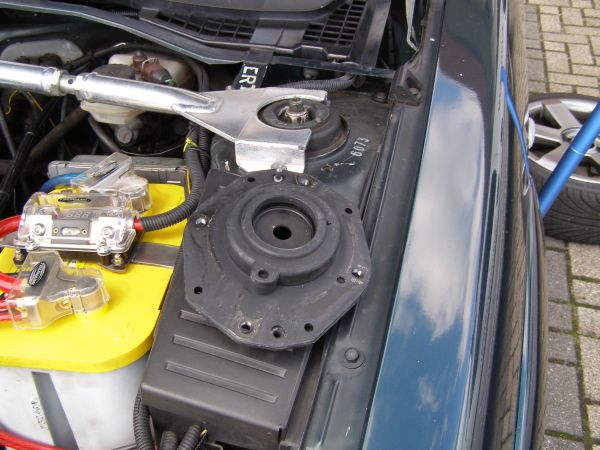

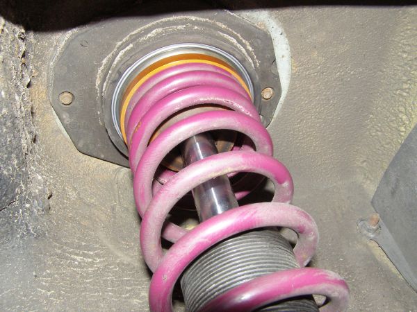

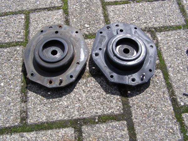

That didnt solve it completely. It appeared that it was the strut mounts that had worn out, so those were replaced too
Cant see from the mounts that theyre worn out, but they are!
