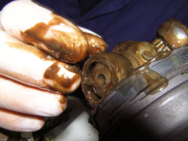

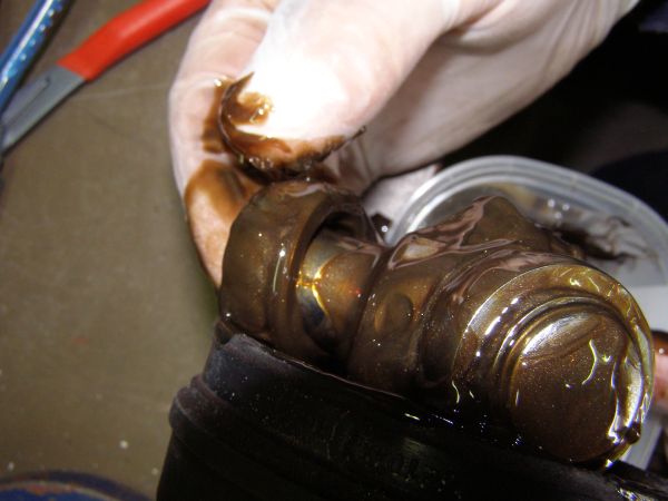

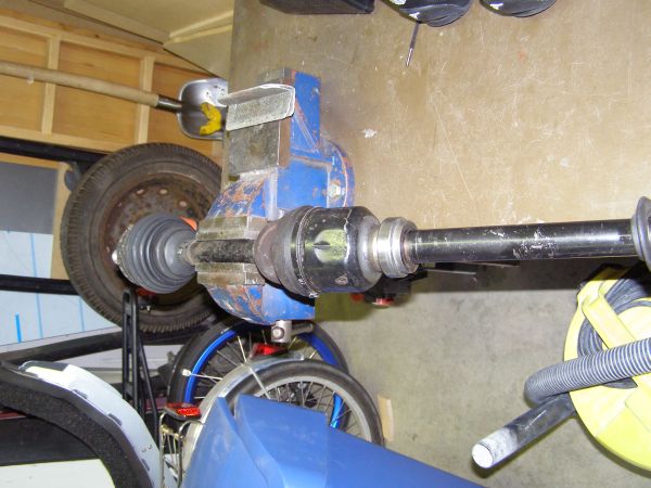

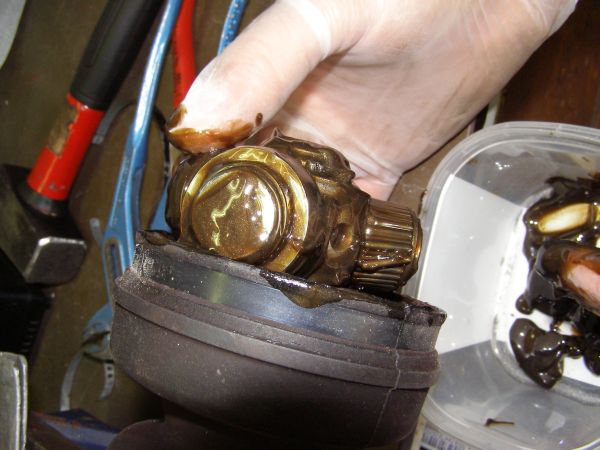

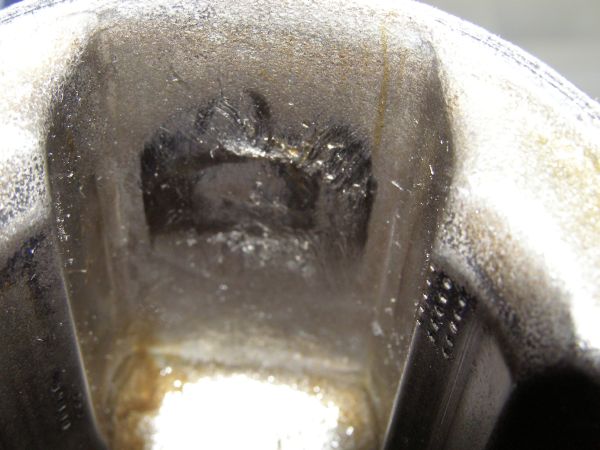

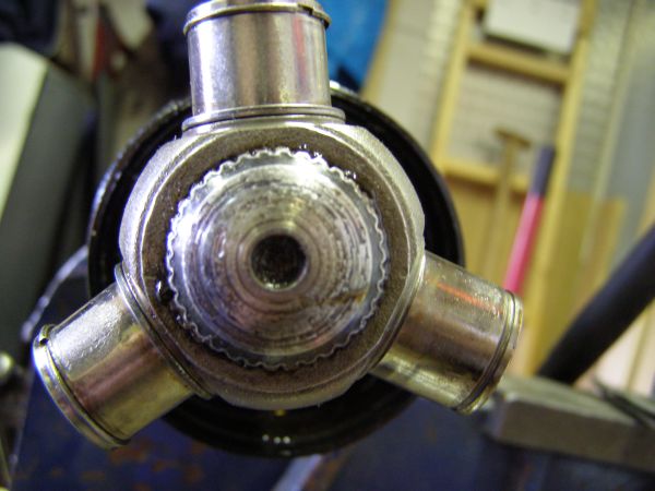

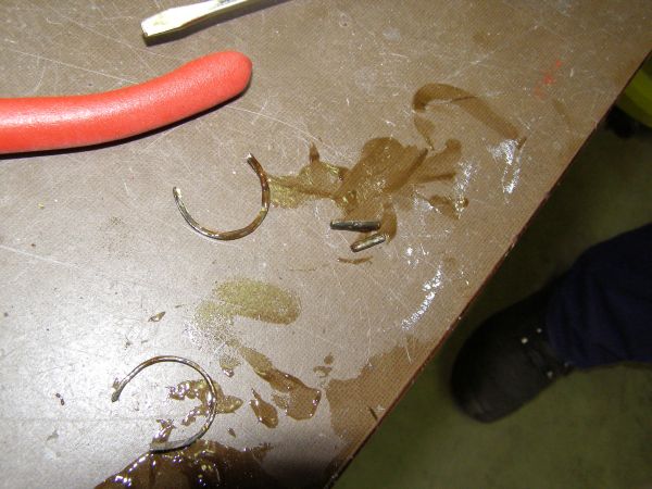

Today I've been working on my righthand driveshaft, after a trackday in Belgium, it failed on the way back home. Car vibrated like crazy with the slightest acceleration :shock: I had already replaced the righthand shaft 2 years/25.000Km ago, so I thought it would be the other short one.
But it wasn't. This axle was a overhauled one from Citroen. I'll never buy one of those again.
On the bench
Metallic grease? Or small pieces of iron??
Hmm lost some bearing rods!
Not good!
Broken parts, even a broken bearing rod!
The surfaces have been damaged by the broken bearing, and also there's some play of the whole thing on the axle, so it it'll have to be replaced.
Also damaged

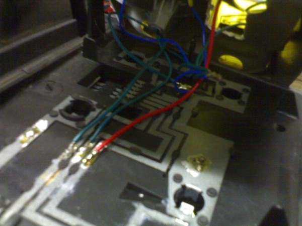

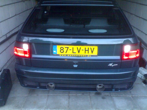

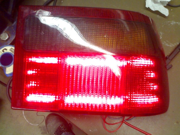

New projects 8)

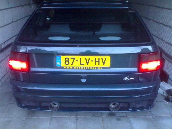

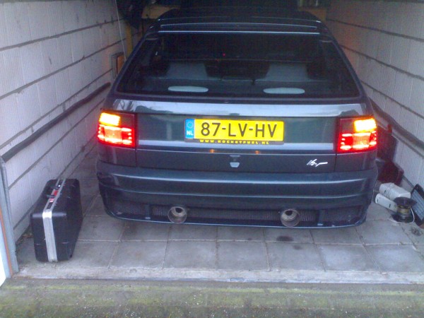

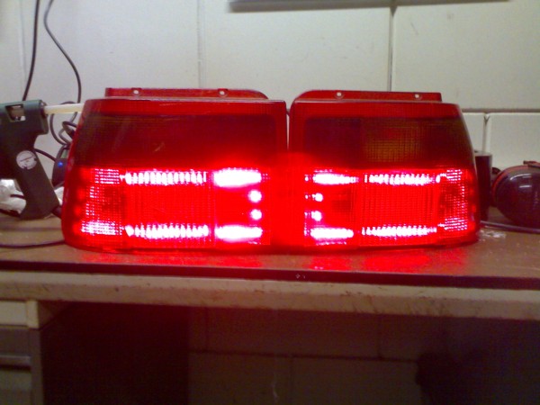

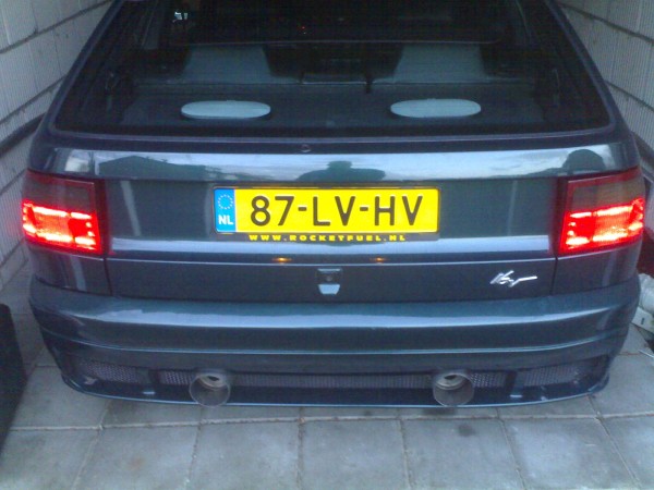

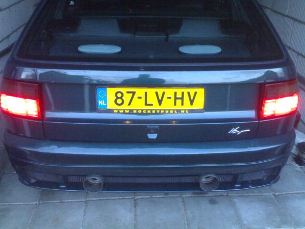

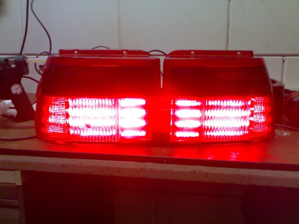

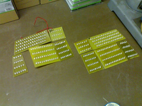

LED conversion rear lights:
Creating a design
leds test ;)
Testing
Brake!
Clusters back in the ZX
Just brake:
Just dipped beam:
Both:
Indicator:
Reverse:

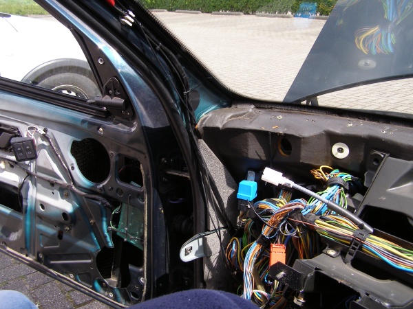

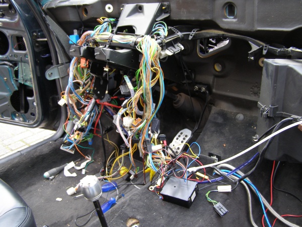

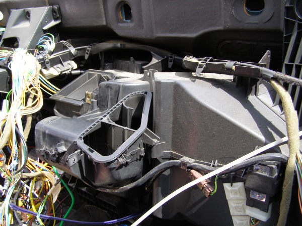

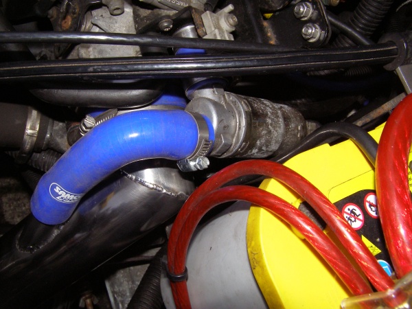

Heater matrix was creating some unwanted coolant smell so it was dying, time to replace it, for that the whole dash needs to be taken out. A good moment to fix wiring neatly, replace the alarm and some other stuff that's use when the dash is out.
Heater is out, AC unit is on the right and does not need to be disconnected, which I feared because it's still an R12 filled system which cant be filled anymore, you'd need to modify it to R134a when it's not working anymore or when it's empty.
The idle intake had it's own filter, but is was too small so now it will breathe through the 'big' air intake.

lots of fun solderin them lights up.do u like the end result?why did u have a filter on the idle value?
16V DAKAR AND WIDEARCHED 16v got another i love them
 Post subject:
PostPosted: Wed May 28, 2008 9:53 pm
Joined: Sun Jul 24, 2005 11:35 am
Posts: 907
Location: Harderwijk - The Netherlands
It needs air and you want it to be clean so thats why ;)

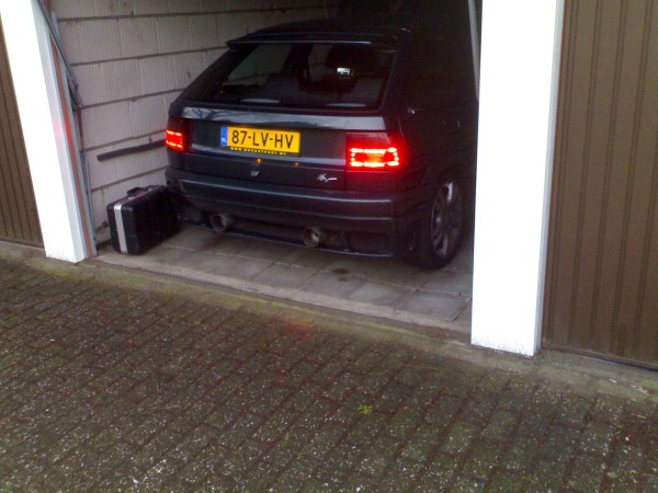

Result of the leds is ok, but there's room for improvement, there will be a 2nd protoype sometimes :P

i was just wondering is ur rear bumber lowerer than a standard bumber or are they the same size?
